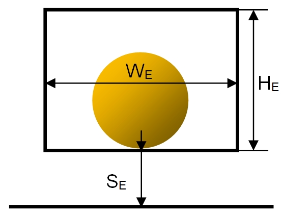

The entrance width WE is at least 60 mm, its height HE is at least 70 mm. Its sill crest SE is somewhere in between 77,5 mm up to 85,0 mm.
Fig. 1 - Entry side view

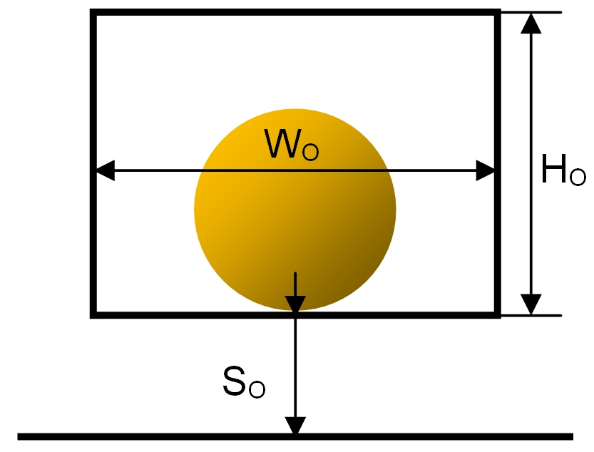

The outlet width WO does not exceed 60 mm, its height HO does not exceed 70 mm. Its sill crest SO is somewhere in between 87,5 mm up to 92,5 mm.
Fig. 2 - Outlet side view

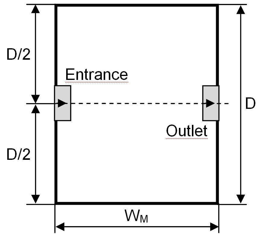

A rectangular base area is reserved to any standard module. Entrance and outlet are located on opposing sides. The maximum usable spatial depth D is defined to be 540 mm, but there is no need to fully use it. The module width WM is exactly an integer multiple of 390 mm. Entrance and outlet are located symmetrically with respect to the centerline of the base area. This centerline is located at half the spatial depth, D/2 = 270 mm.
Fig. 3 - Bird’s eye view

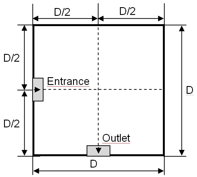

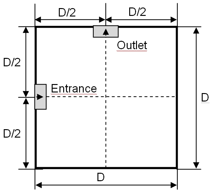

A square base area of edge length D = 540 mm is reserved for a corner module. Neither edge length needs to be used fully. Entrance and outlet are located at adjacent sides. Entrance as well as outlet are located symmetrically to the respective centerline of the base area. Those centerlines are located at half the spatial depth, D/2 = 270 mm, each.
Fig. 4 - Left hand corner, bird’s eye view
Fig. 5 - Right hand corner, bird’s eye view
