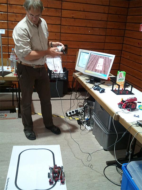

Mit einer Spielkonsolen-Fernsteuerung gesteuert.
vleeuwen (26.9.2011, 13:11:01)
A trail sensor FT-bot under control of a XBOX360 controller or Logitech game controller. But under MS-RDS other DirectX compatible controllers can be used. There is also a driver for the WII controllers like the balance board,
On the monitor you can see a simulation of an FT-bot with trail follower.
On the table an TX-L based trail follower. MS-RDS can handle both the TX-C, TX-L and the RoboInterface family.
vleeuwen (26.9.2011, 13:14:24)
The trail sensor activity in MS-RDS is able to handle the complete state machine for the two binairy sensors in the trail sensor and enable/disable.
