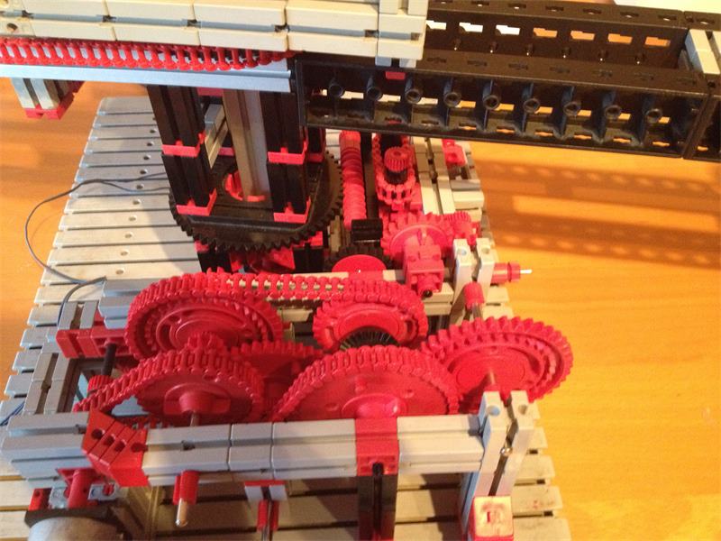

Rotation around the sun
Konstruiert und fotografiert von Richard van Wijk.
Hochgeladen am 10.1.2016, 17:44 von rvwijk.  2 / 10
The delay for the orbit around the sun is through a series of gears including a differential to create an unusual division of 1.574. The total division for an orbit around the sun is: (4 x 3 x 1.574 x 58) / 3 = 365.168
Stefan Falk (10.1.2016, 18:09:56)
geometer will enjoy this ;-) As much as I do - I love models where the motor’s force is brought to the needed places by clever mechanics! Great!
